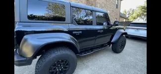

My wife booked a trip for us to take the Braptor to Moab and I have already seen some horror stories of people bending their factory rock rails. After taking them off and comparing to the metal tech ones I can see why. I worked with the owner of this company since I am the first one to try these out on a Braptor. They were in no way free, but he was going to help out on the freight if they didn’t work. Great guy and he even talked to me on the phone about mounting and answered texts if I had questions. These are true frame mounted sliders and rated for the weight of this vehicle. It took me about 6 hours by myself to do both and I recommend having a friend help if anyone else wants to get these. They are about 70 pounds each. I bet the factory steps and sliders weight about as much as one of these combined. I definitely don’t feel like any rocks will bend these into my doors. There were a couple things I had to do differently when installing these compared to the regular Bronco, but they turned out great in my opinion. If anyone has questions feel free to reach out.

Those look nice and should provide you with a little more protection out on the trails. Do they hang any lower than the stock rails with the running boards or are they about the same?

Was on their site just prior to posting this and they offer different angles on how you want them to sit. With or without the factory rails. Bold to the frame with grade 8 bolts and a backer plate.
I was worried about the same thing before install. They are in between where the factory rails were and where the steps were. They are not quite as tight to the body as the factory rock rails, but they are definitely not as low as the steps are when mounted to the rails. I probably lost an inch or so of clearance, but I still have a step all the time now for the wife and kid and I have confidence in protection.
