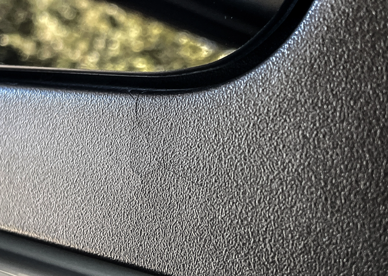

My initial, rather small crack has spread a bit and I now have a bunch of new ones on the driver's side cargo shell. All are around the side windows which, ironically, are part of the recall and my Bronco is affected. They sold it to me knowing the recall hadn't been done. I was aware and knew I'd need to come back for the window seal and the crack.
I'm actually sitting at the dealer right now and they apparently need a couple of hours to are done examining before and have said the cargo section of the top needs to be replaced. Was approved almost immediately so that's good.
Right now physical cracks are limited to the cargo portion of the roof. I have a very wavy finish on one corner of the passenger's side front panel. It's visible and you can definitely feel it by touch and they've submitted that to Ford for further review. I've not seen any other cracks on either the rear passenger panel or either front panels. Generally, I have the honeycomb pattern throughout but I actually don't mind that. I'm weird.
Pics. This is the one I knew about when I bought it. It has since grown/expanded out and this is an accurate representation as of today. Driver's side towards the front of the rear cargo area.

My rear shell was replaced last year for the same cracking around the windows. It was brand new on the lot. I had them order a replacement while I signed paperwork. 303 isn’t the problem.

Just had mine replaced a couple of weeks ago. The cracking was between the window and the rear door on the driver side- just in the flat area not touching the window.
