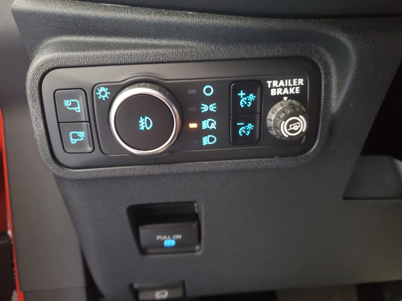

So I just installed the Bronco Trailer Brake Controller that we purchased from Ford Performance. The Controller is made by REDARC, simple plug and play. I then contacted Ford to see if I needed to have the OBDII changed to enable the trailer brake control module and the trailer brake control gain setting, which they said yes and wanted $250 bucks. I figured it would be easy enough just to get FORScan and do it myself. Everything was pretty straight forward until I was looking down the list of the IPC Module Configuration and discovered there was no specific Trailer Brake Module or Trailer Brake Gain Setting.
Question, will the Trailer Brake Controller simply work once we connect a travel trailer without needing to change anything in the OBDII?

I have a non Ford trailer brake controller. Uses existing brake control plug. Works fine with no software update needed. 23 Raptor.
I had the Ford trailer brake controller installed on my 2023 Bronco Raptor. Although I didn't specifically watch the tech go through the program line by line he did have his laptop connected to complete the programming of the brake controller. I can't answer your specify question because I'm just unsure. I know mine has worked flawlessly since it's been installed. I have heard and read various installs where "They" said it was supposedly plug and play and be on your way. My small hometown Dealer said differently and well I have too much invested in RaptaSquatch to take that chance!

I can understand the frustration and I definitely didn't mean to add to it. I may be completely wrong with what I am about to say but again I wasn't taking the chance with my Raptor.
A lot of these modern day vehicles are using a CAN Bus system for signaling which in my thought process probably would apply to braking also. If RedArc is tapping into that signal "which I do not know" it could be important. The Ford Accessories Store even list "custom ECU to help manage brake signals". Anyway I'm not trying to sell you to the idea...I think I just started rambling my thoughts and couldn't stop...haha. Best of luck!
