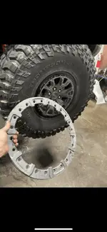

Also got the OEM beadlocks that came in installed last week
Pretty straight forward to install
Just make sure to lube tire area where it contacts
And torque to spec
I actually went over the recommended 47 ft lbs to 50
And double cycled it to make sure there were no stragglers that were loose
